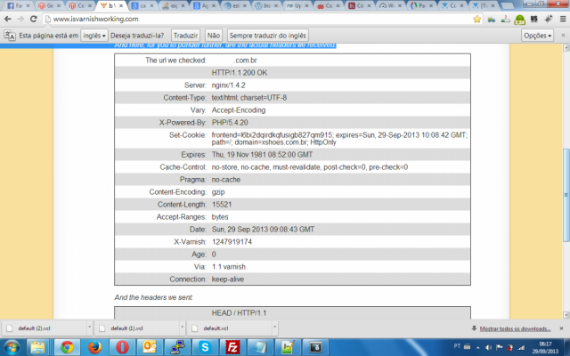

Justamente foi esse mesmo tuto que usei para montar o server, muito bom por sinal, parabens, usando um módulo para magento acabei conseguindo fazer funfar, mas ao testar o Varnish no site http://www.isvarnishworking.com/ aparece a seguinte msg:
Yes!
Sort of!
Varnish appears to be responding at that url, but the "Age" header is less than 1.
This means that either, 1) you checked right when Varnish cleared it's cache for that url, or 2) for whatever reason Varnish is not actually serving the content for that url from cache.
If it is the former, just check again and see if you get a more solid confirmation.
If it is the latter, perhaps one of the following is happening:
  • That url is excluded from the cache on purpose in the Varnish vcl file (in which case, yay! It's working.)
  • The application is sending cache headers that are telling Varnish not to serve that content from cache. This means you'll have to fix the cache headers the application is sending to Varnish. A lot of the time those headers are Cache-Control and/or Expires.
  • The application is setting a session cookie, which can prevent Varnish from serving content from cache. This means you'll have to update the application and make it not send a session cookie for anonymous traffic.
  • Internet Ghosts.
And here, for you to ponder further, are the actual headers we received:
post-15516-0-51362700-1380446454_thumb.p
O que fazer nesse caso amigo ? Outra pergunta, é possivel configurar o vcl_fetch para ambos CMS ? Se sim como eu poderia fazer isso ? Obrigado pela ajuda e parabens novamente pelo excelente tuto !!!
Basicamente ele disse que está funcionando, mas não tão automatizado. Se você usa o Cloudflare não confie nele, testei com um site onde tem o cloudflare ele diz que não tem o Varnish :S.
